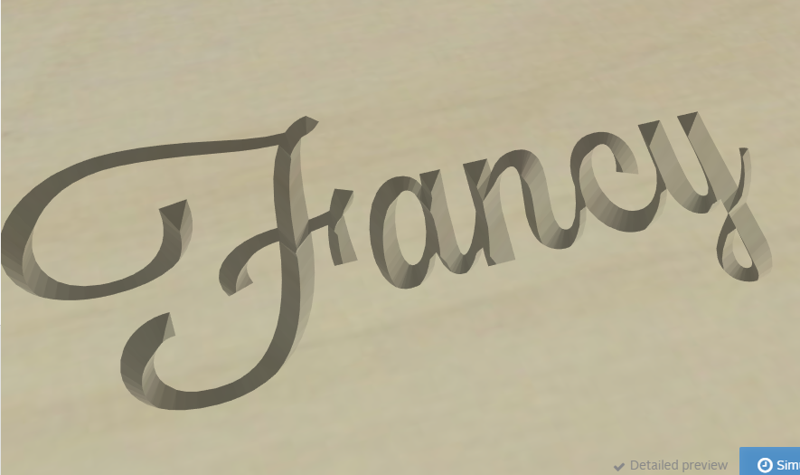

Personally I would just use the 60 degree v bit for any script. This is simulated at 1/4 inch cut to me it looks more like it was traditionally carved.
Yeah, that’s what I would recommend. A v bit is probably a better choice unless you have a good reason not to use one. They are great for engraving text, and much harder to break. It will also go a lot faster.

Thanks for all the good advice. I have ordered a couple of 1/16th already but I’ll try out the V bit too. I agree it has a good look.
