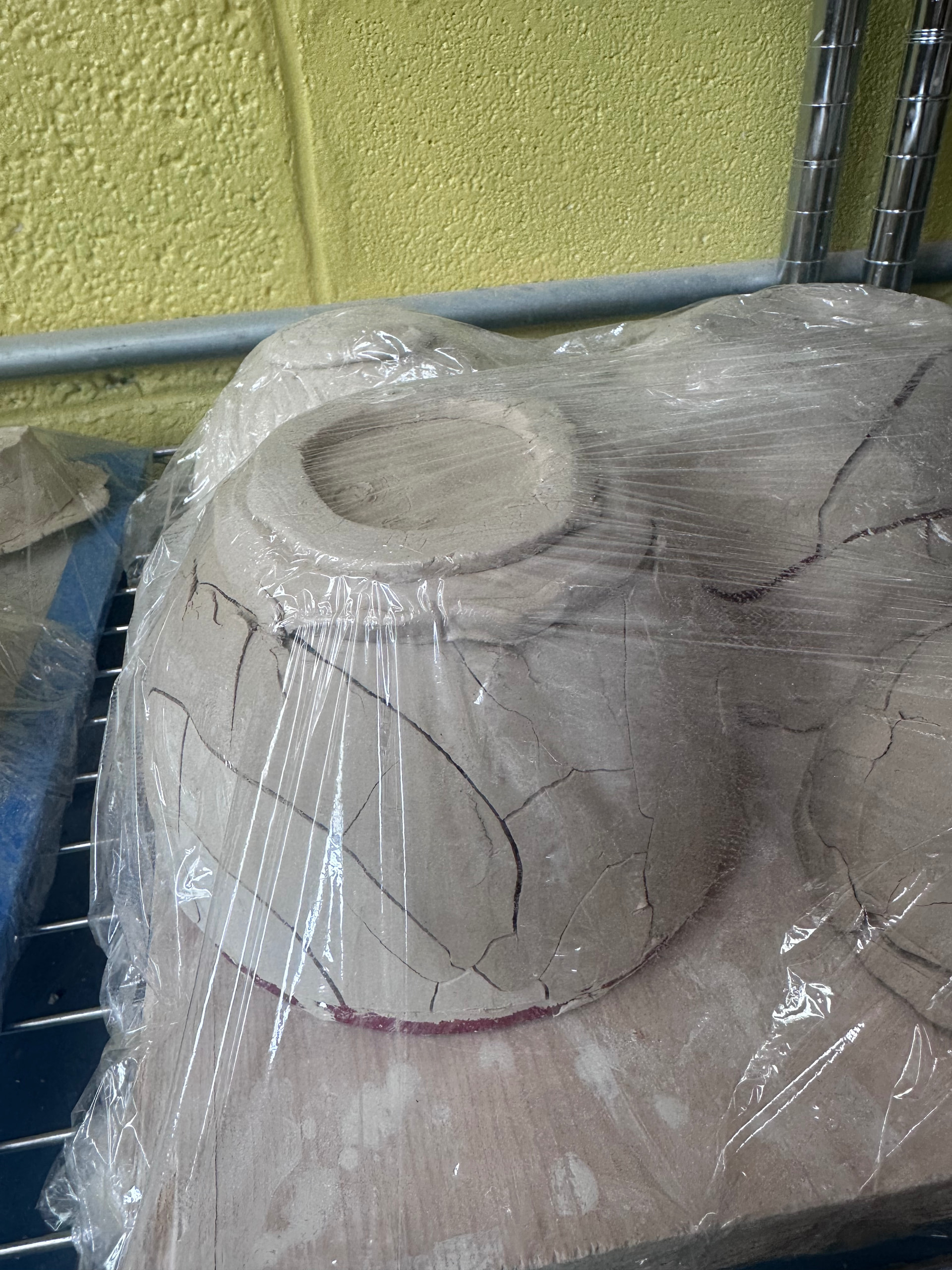

Reminder- if you make a piece by draping the clay Over a bowl, dish etc you have to remove your piece from the form as soon as it is dry enough to hold its shape. - typically the session. Clay shrinks as it dries and causes cracking in the clay because the form doesn’t shrink.
There are several clay bowls here on the drying racks still draped over the actual bowls. All are cracked beyond repair.
