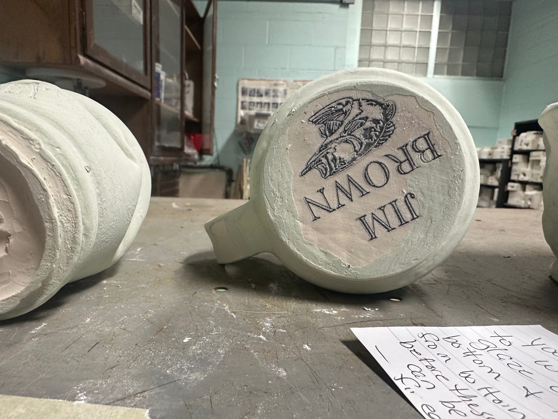

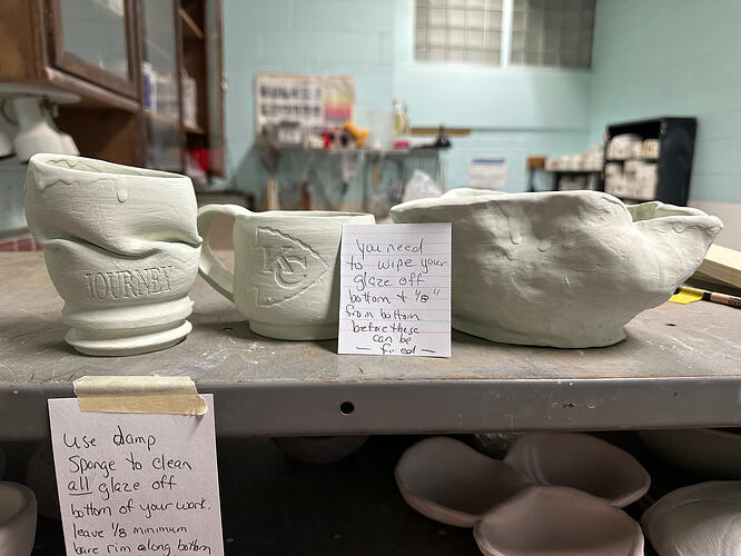

Maker- you need to use a damp sponge and clean the glaze from the bottom
These three pieces all have the glaze wrapped all the way onto the bottoms. The maker needs to come clean the bottoms and the lowest 1/8 inch with a damp sponge before these can be fired.
Underglaze in the recessed writing should be okay but there is glaze also on the bottoms of all your pieces.
