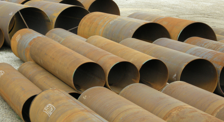

We need some heavy 5 or 6 inch pipe. Old oil field casing or similar. To protect the building, we need to set two of these between the dumpster and the building, 2 at 5 or 6 feet long would be great. If someone has access to them, we can pick them up.

Oil field pipe post pre cut 2 3/8 to 5 1/2

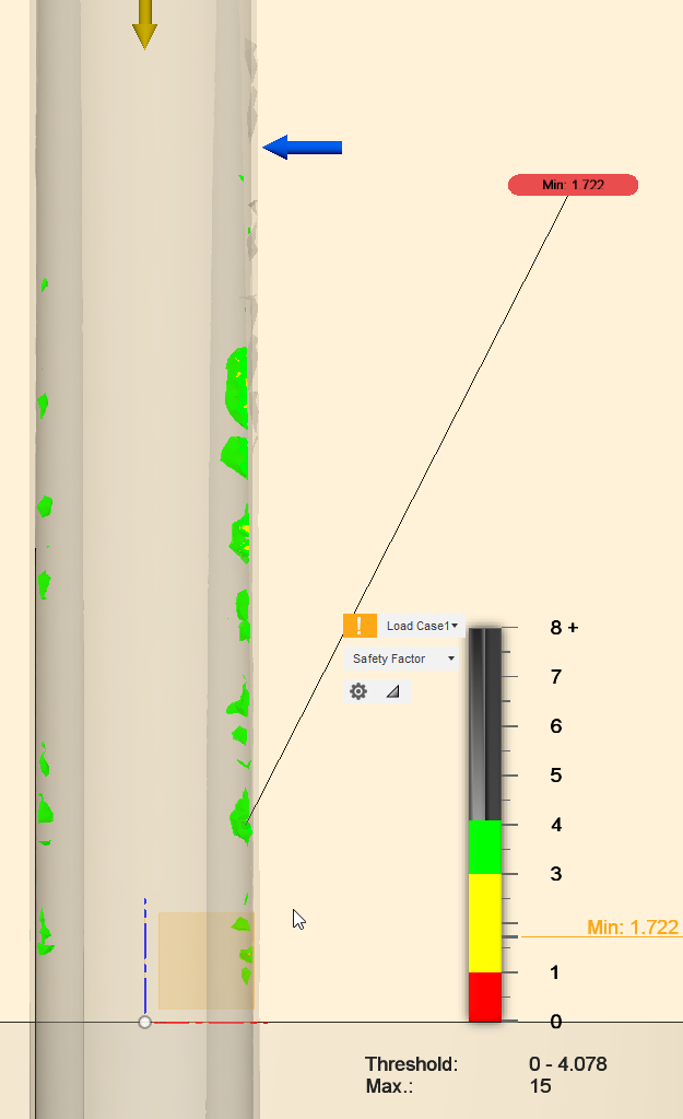

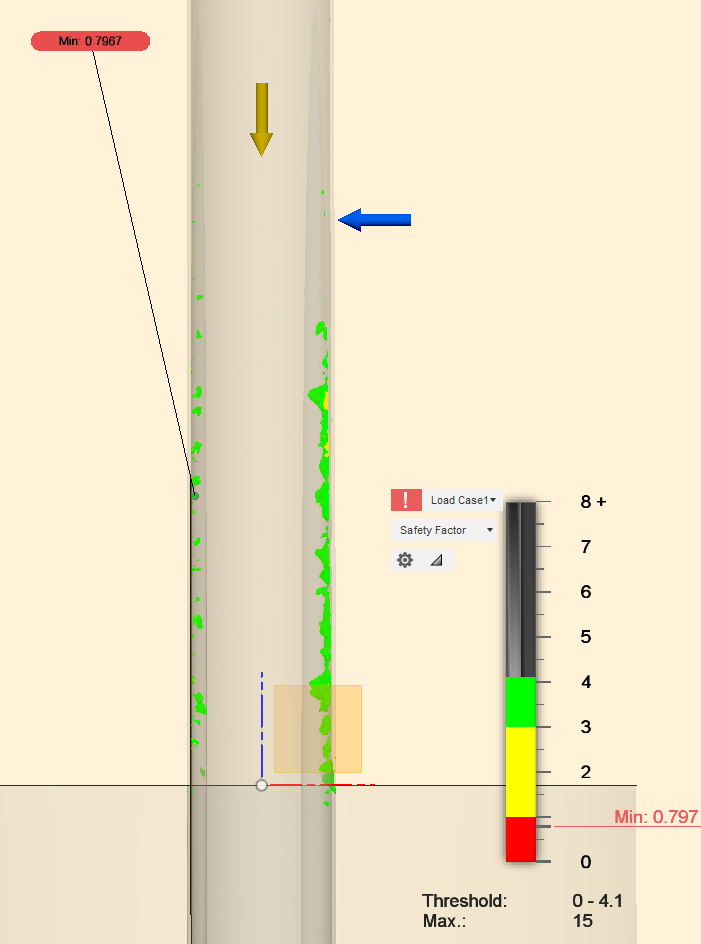

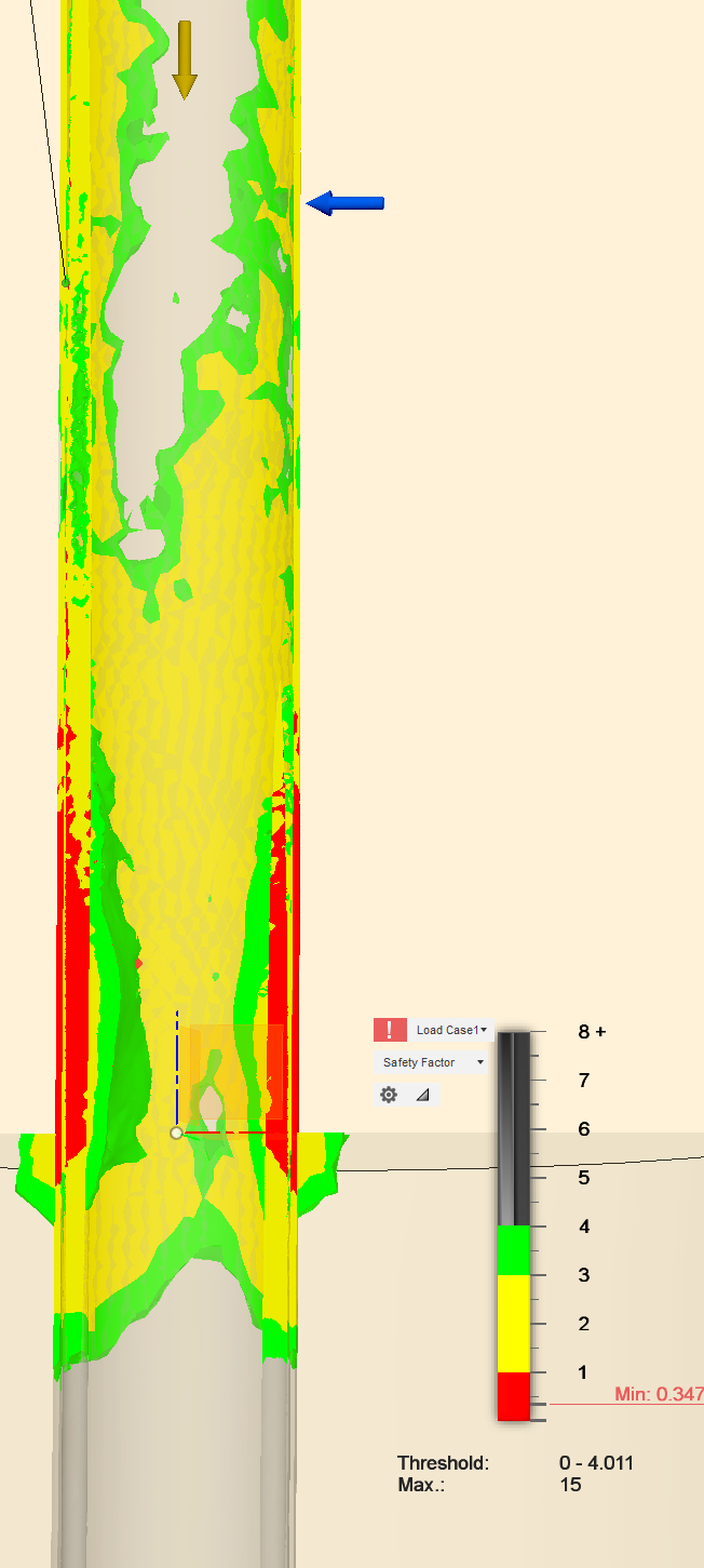

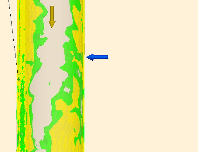

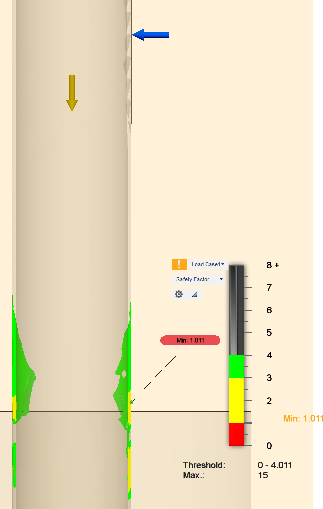

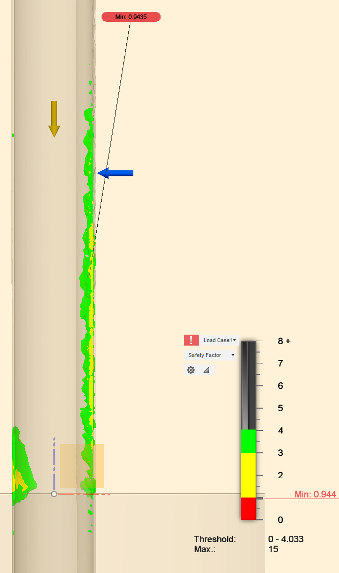

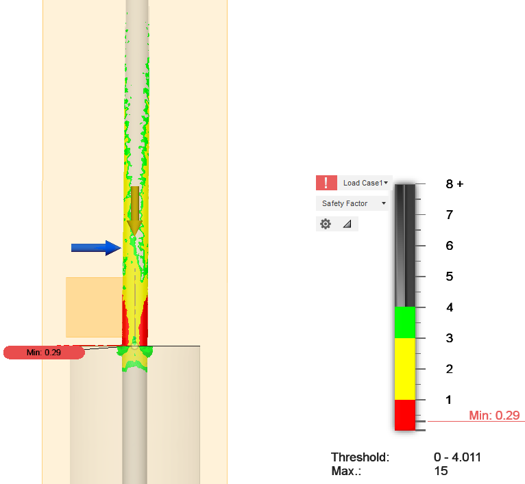

I ran a few simulations in Fusion 360. If you look at the pictures. No color shows it is over 4 times safety rating of the the material at the simulated load. Red is below the failure point it will not rebound (I think). The moral of the story. The most steel the better. Duh.
I checked a few combinations ranging from 2 3/8 corner post 16 gauge (FP), to 4" 1/8. I ran a few simulations with varying amounts of rebar ranging from #2(1/4") #4(1/2"). I ran a 3 ton force applied the post about 6-12" above the ground.
2-3/8 x 6’ menards under $17 (very close to JC at lowes). 20’ #4 rebar $7. Depending on how large/deep the hole is $5-$15 (ready mix) concrete.
FP by it self is very weak compared to the others, less steel.
FP with a #4 (1/2") rebar added on the leading ledge.
FP + #2 + #2 (1/4" rebar)
FP+ #4+#2
FP+ #4 +#4
4" steel 1/8" thick wall.
The Zoning Requirement is to screen the dumpster. A 6 or 8 feet long screen from the building out would be acceptable. The key is the forklift action of the trash truck. The dumpster moves backwards, over time. I have had replace a chain link fence in the 1980’s due to this. (The dempster was lowered onto the fence).
The comment about also protecting the end post supporting the screen is valid. There have been several good suggestions from this post. Your Fusion 360 analysis confirms my experience.

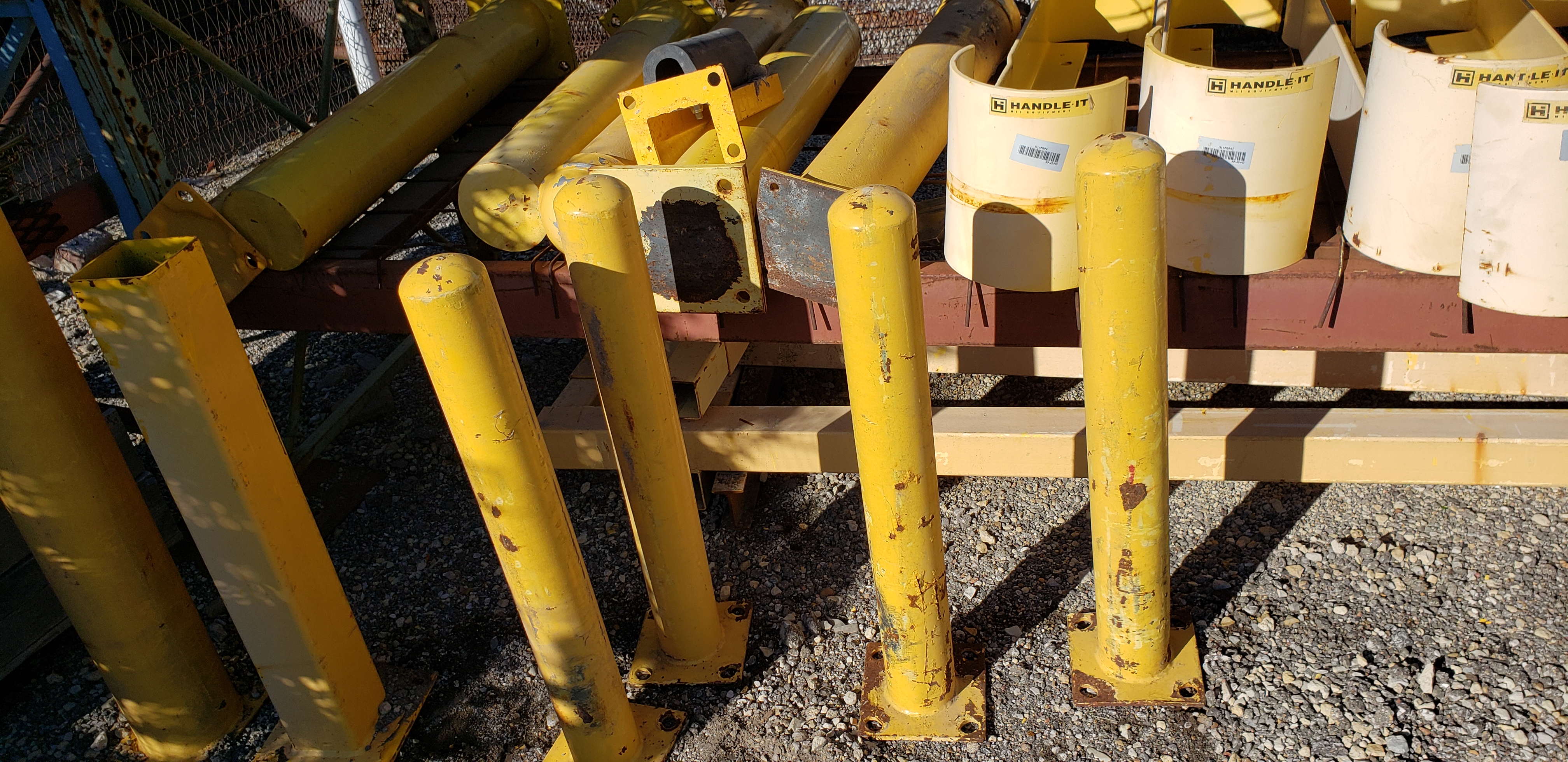

I was at the yard over lunch. they have some used bollards for $25 a piece. the larger ones are 6.5in by 40in. the smaller ones are 4in x 36.
I doubt we could make our own for that. We’d still need to pour a base for them, but still…any other opinions (In this group? Srsly?)?
