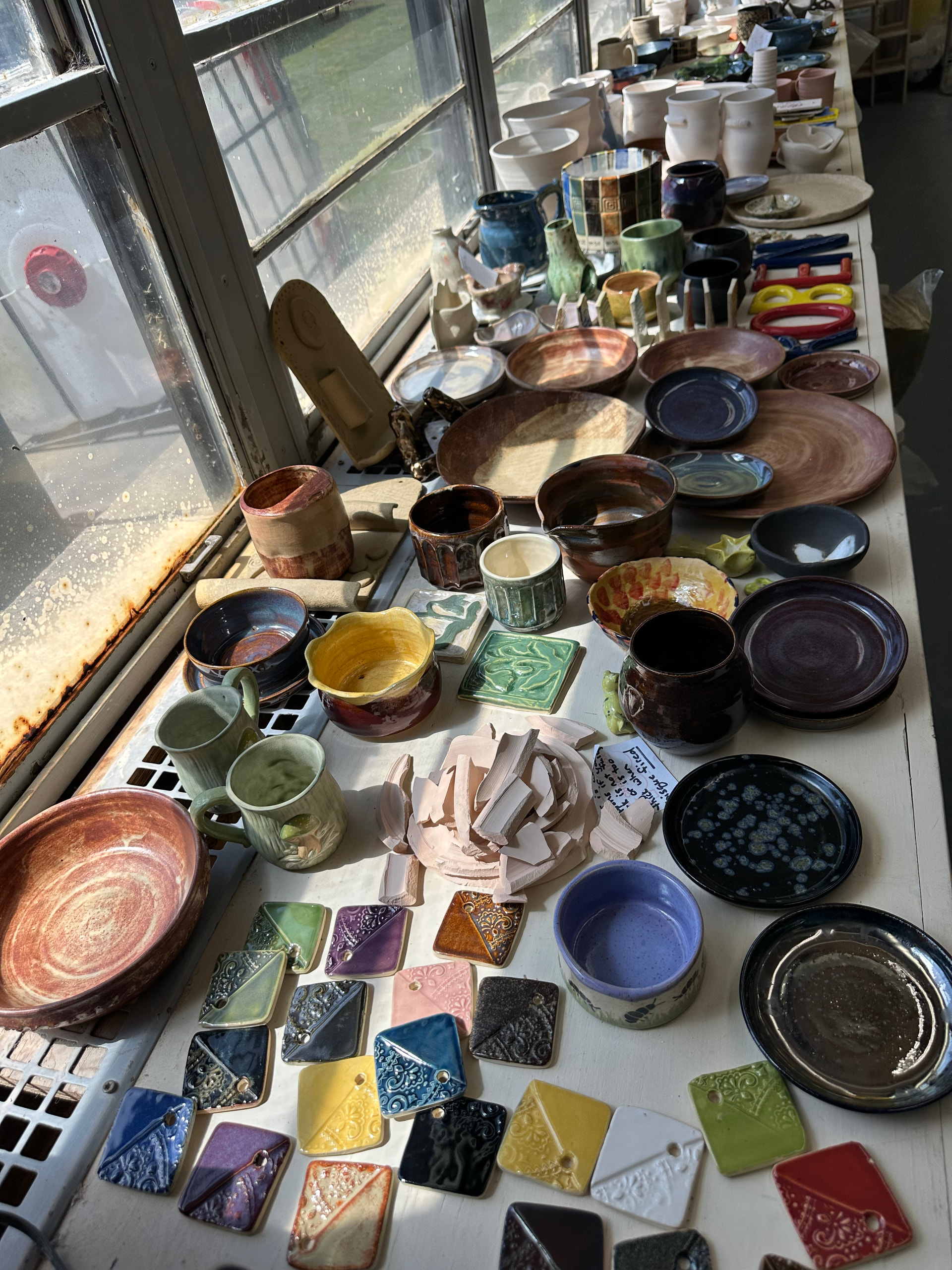

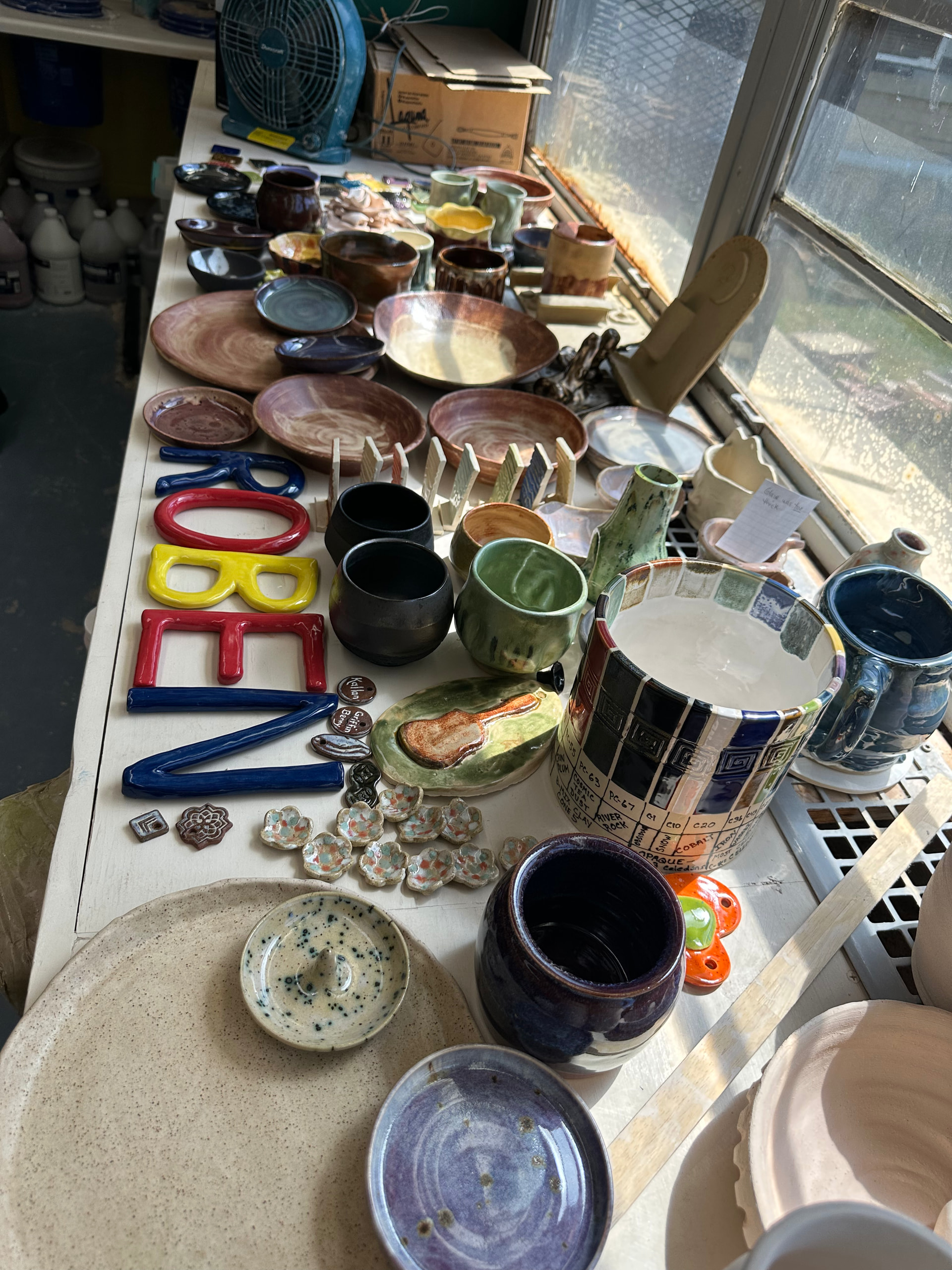

Mostly successful, but there were a few pieces glazed too heavily and they ran. Thankfully we had placed kiln cookies under each so our kiln shelves were saved.
For best success-
If you brush on glaze from the pint jars, apply 3 even coats brushed in opposite directions each coat. (Altering Horizontal and vertical). If you add any layers, keep layer to the top 1/4 to 1/3 unless you really know how your two glazes interact.
Please only dip once if you use dipping glaze and remember it should be a quick dip- like 2 seconds. Note - no one is currently monitoring and adjusting the dipping glazes. Some are likely way too thick for current use. Do not add a brush on glaze over or under a dip glaze. They are not compatible.
