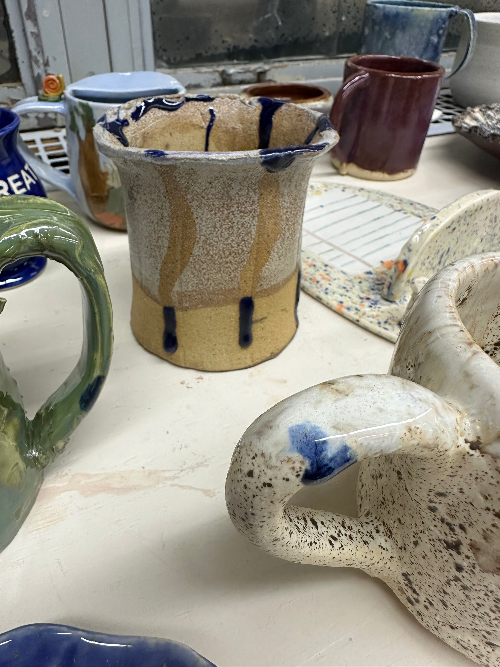

Also, don’t mix dip glaze and brush glaze. A piece where cobalt was dripped on the piece actually jumped (popped) some of the cobalt completely off in the kiln firing. I’m not positive if it was dipped first, but it appears maybe that’s what happened. It popped cobalt blue onto two other people’s work. It also made a mess in the kiln for us to have to clean up. I’m sure it was just an unfortunate accident, but also something we all need to try to learn from.
