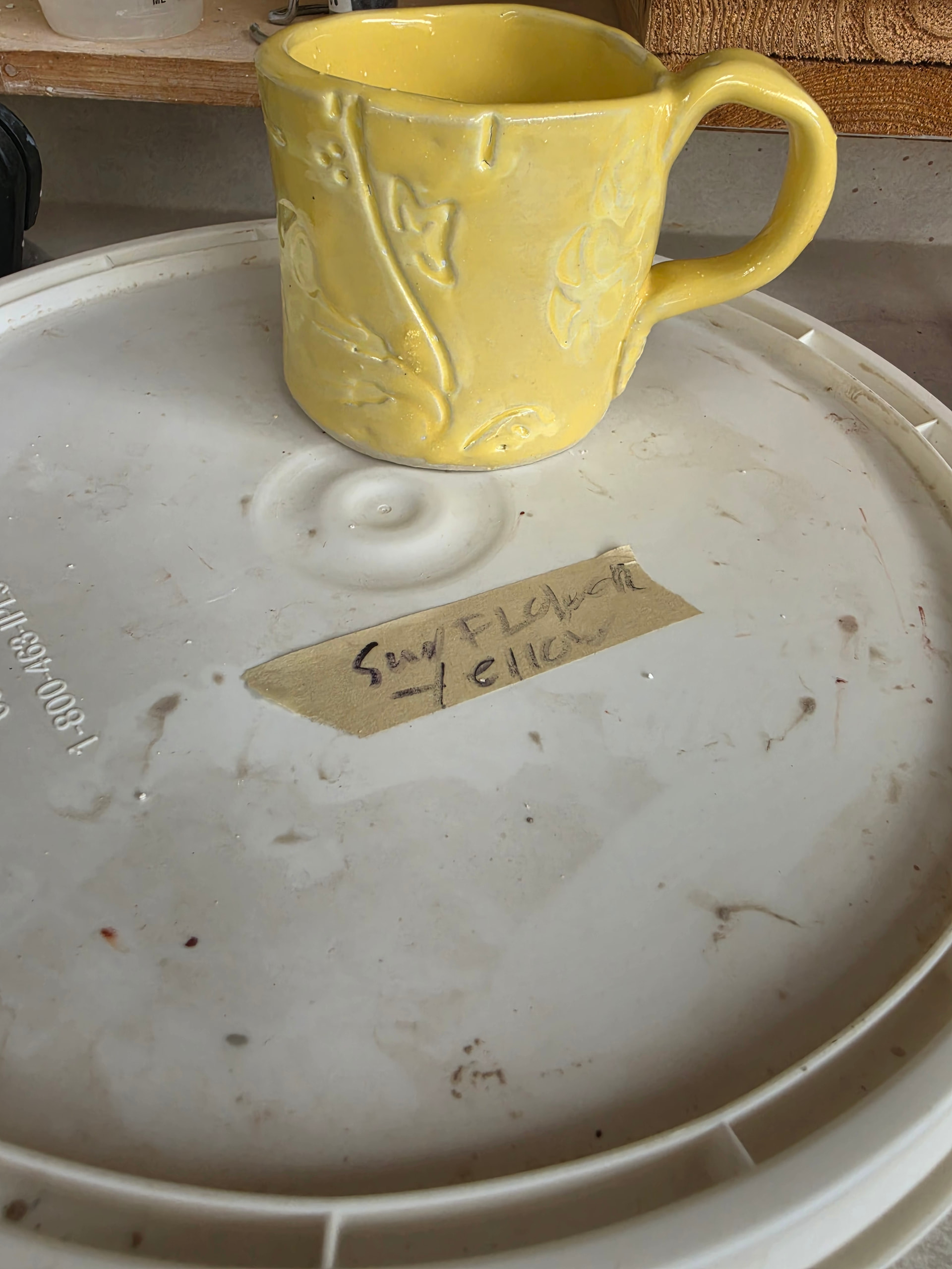

im personily quite pleased with the results of the bad idea bucket

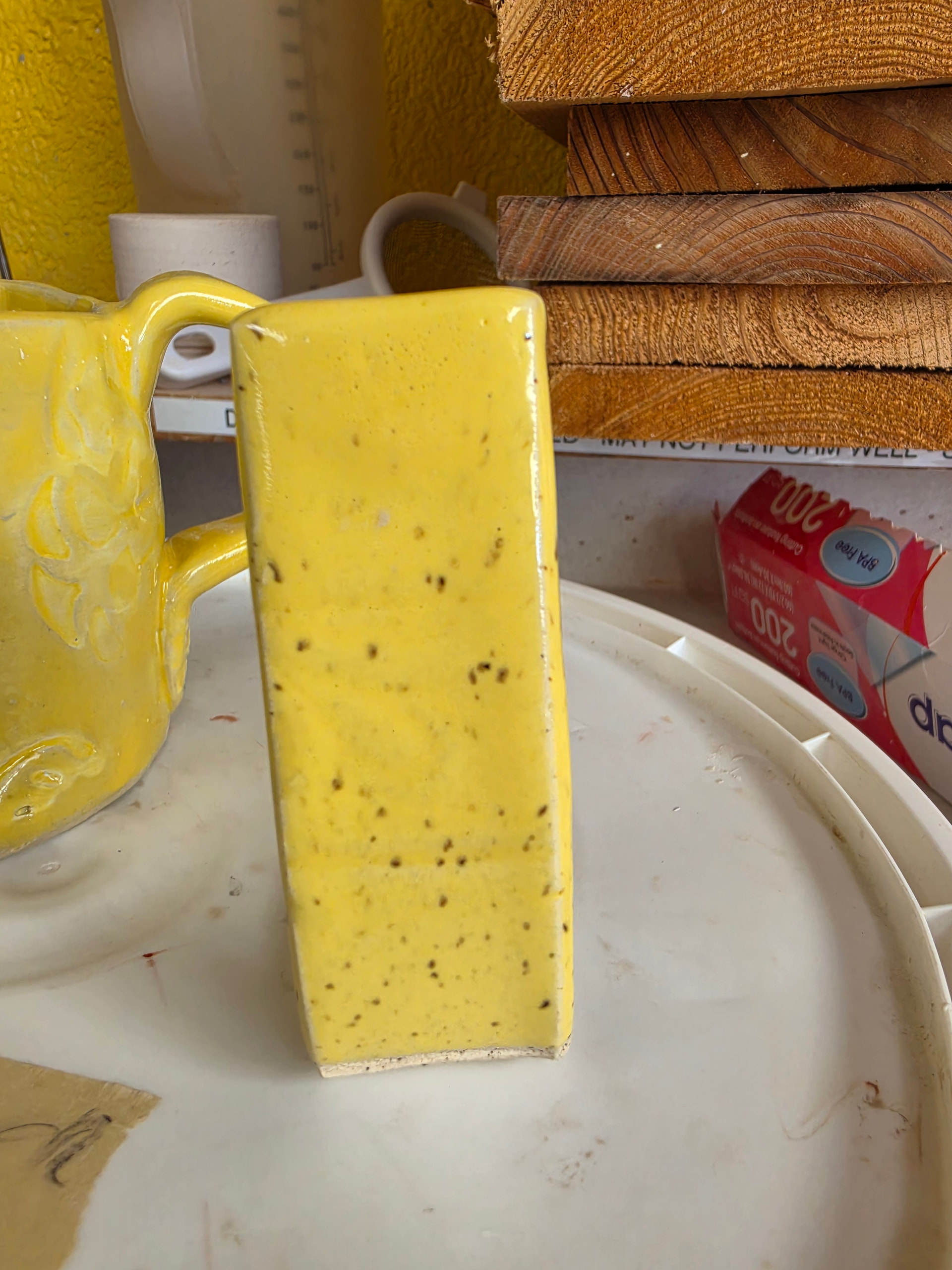

I think that yellow needs to be seived. I noticed when the mug came out of the kiln that it appears to have oolites or similar in the glaze.
ill take care of that next time im in thanks for the heads up!
LOVE THE YELLOW!!! Good work!!

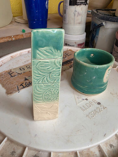

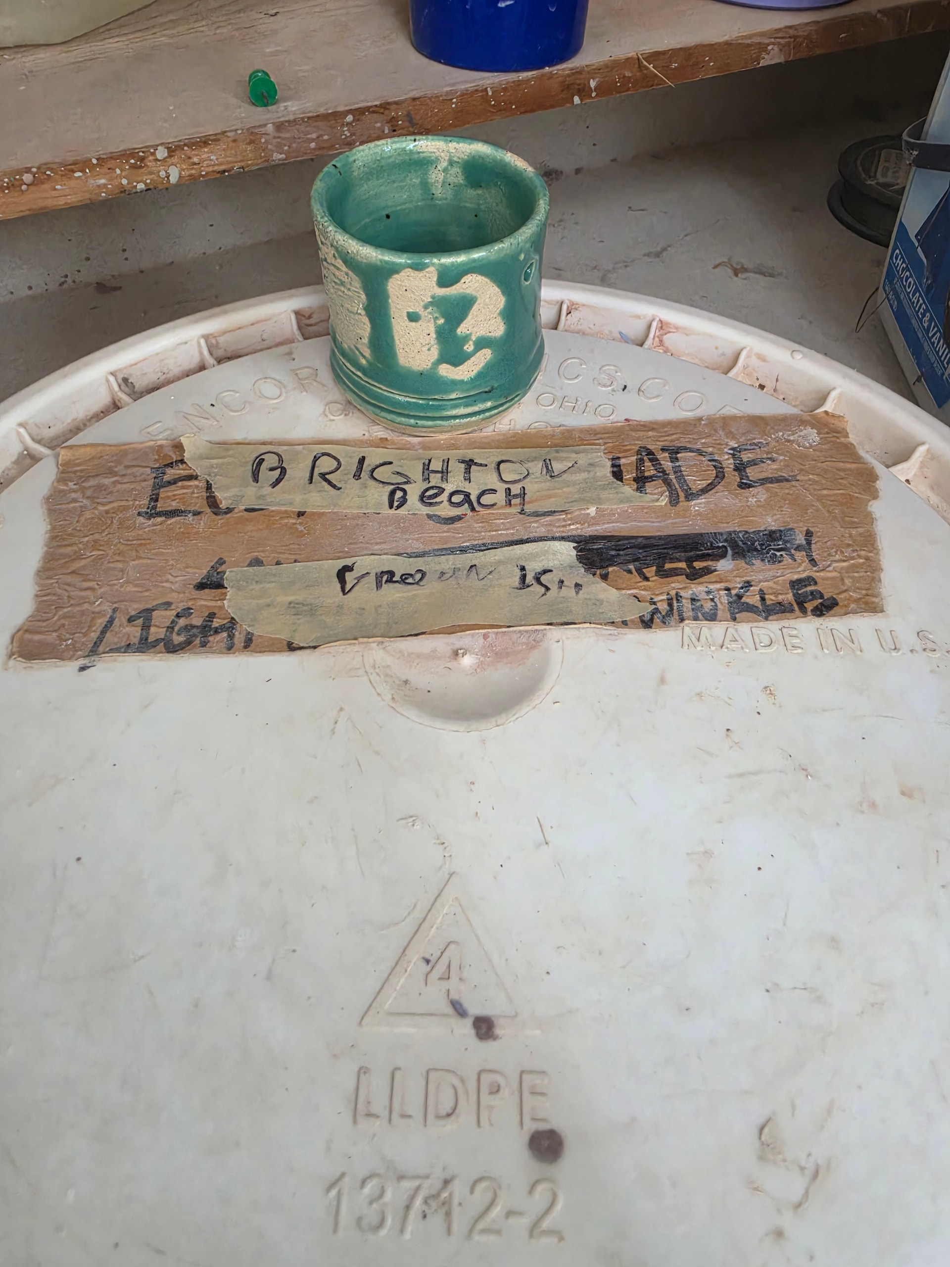

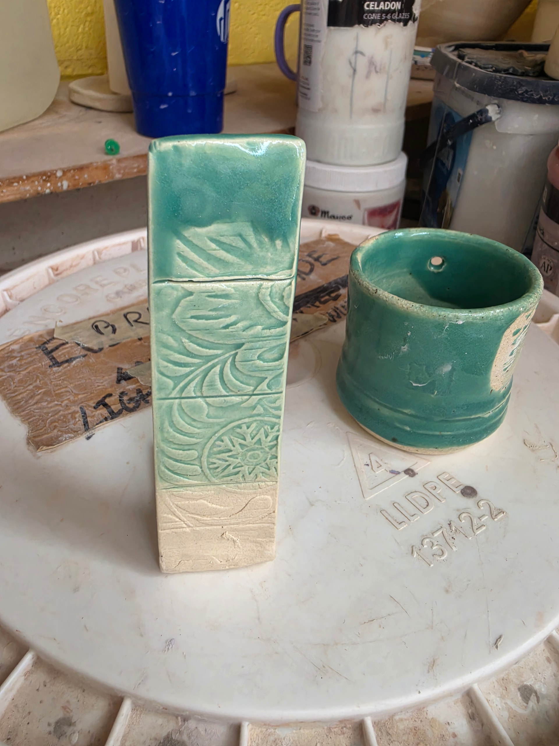

tests of the dip glazes 1 secand dip for the bottem inch 2 for the middle 3 for the top. the brighton beach (green one) is a bit thin at the momant you may want a 3-4 secand dip for that one
note i may have axadentaly used my speckled clay for theas.
