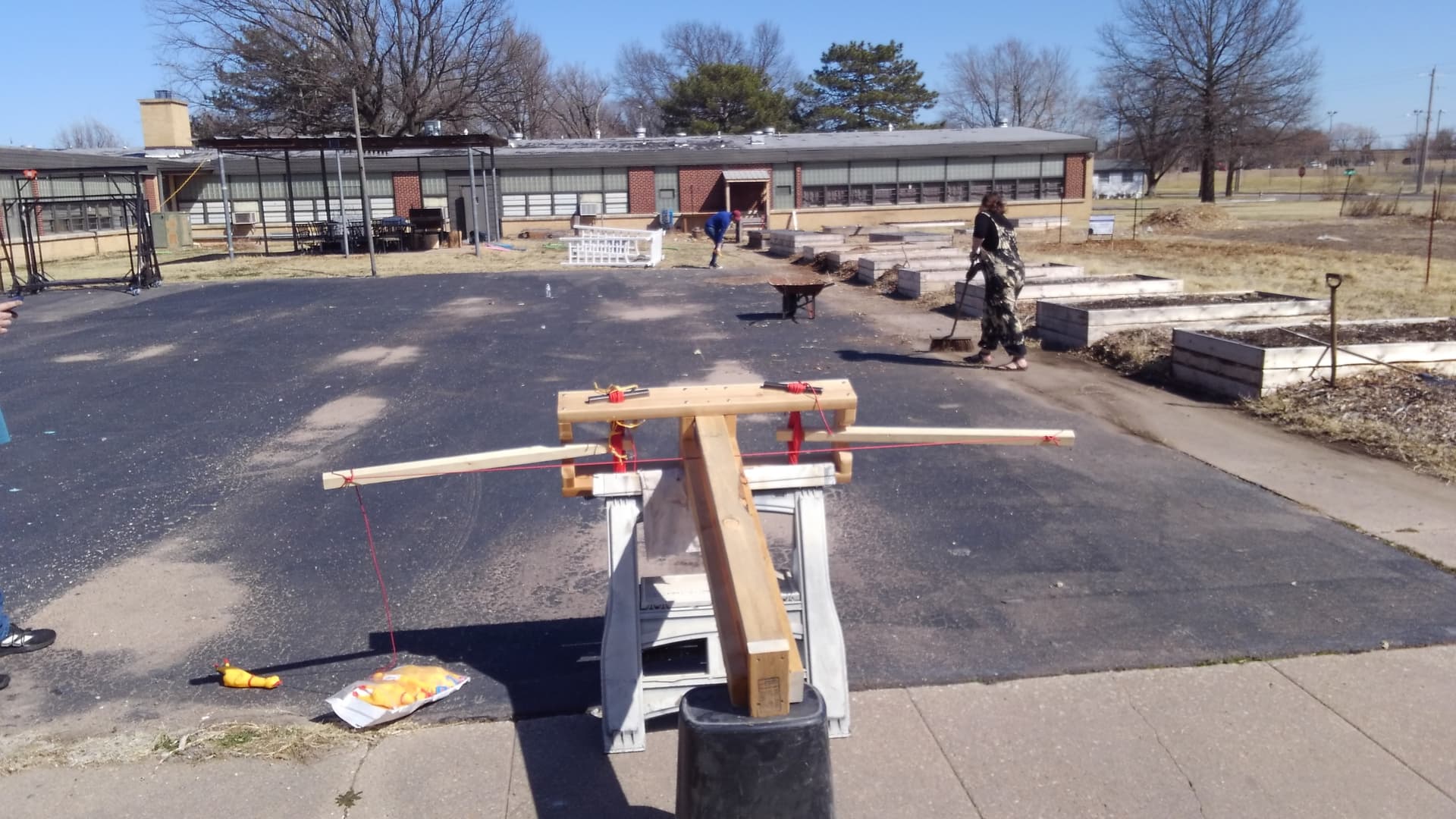

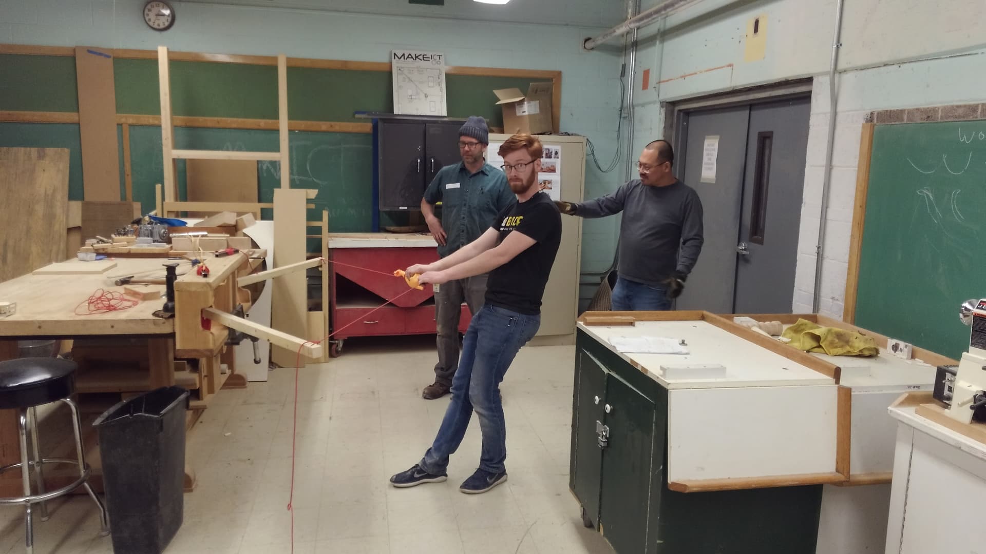

Made some exciting progress tonight!
We’ve made a prototype of the torsion box! …and definitely learned a few things.
  1. Paracord can create a crazy amount of force that can easily bend and crack a 2x6
  2. While loading the cord onto a card and then threading the cord in mass through a hole is quick, it does not create an even tension through all of the cords (means the machine would have to be re-tensioned more often)
  3. It helps with threading to make the holes slightly larger than the width of the torsion arms (ie - a 2in hole would be appropriate for a 2x2 arm)
  4. The hallways are not quiet big enough to fire medieval siege engines.
  5. Rubber chickens do scream when launched from a ballista

Btw, the prototype does a pretty good job of lobbing chickens outdoors…
So maybe we should see if we can come up with some armor for them. Lol
Chicken flingin’ good!
