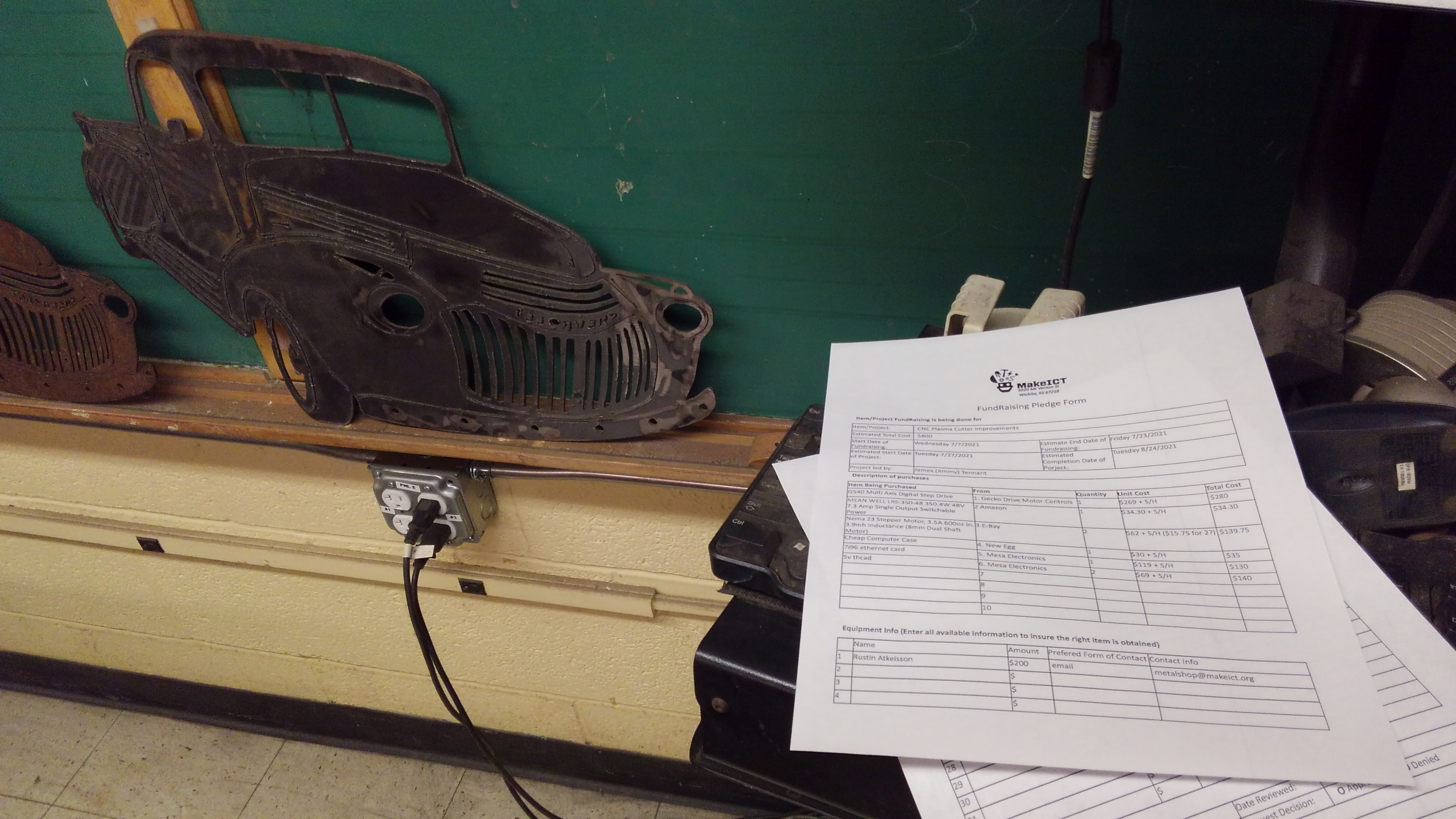

There’s been some interest in upgrading two of the machines in the metalshop. So we’re looking at doing some fund raising since this goes above and beyond just having the equipment operational.
Since nothing is committed yet, I’m trying out some pledge forms to help organize the chaos before we pull the trigger on these projects. You can either drop a message here saying you would like to pledge $x amount for a certain project, or you can write down the amount you want to pledge on the printed forms by the equipment.
